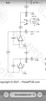

With over 50 pedals (ranging from stripboards to kits) and 2 amp builds under my belt, I've finally run into a problem that's got me a bit stumped. I was pumped to build the Caesar, but I'm struggling to get any joy.
Behavior
Everything behaves as it should when bypassed. When powered, the indicator LED is on, but the rate indicator remains unblinking. When the blend knob is set to fully dry, the clean signal comes through as it should. As the blend knob moves towards wet, there is no signal.
What I've Tried
All of the following have been tried since taking the attached pictures.
Slowly tweaking the trim pot.
Reflowed all joints (has worked for 95% of the problems that I've encountered) and scrubbed PCB with alcohol.
A check of component values. I went through each component and confirmed values against the sheet, but if I missed one on install, there's a nonzero chance that I bungled the inspection too.
Some audio probing. I can get the clean signal from input through output. At no point have I heard anything close to a modulated signal. I can get sound coming off a few IC pins.
Switched the 9.1V diode. I wondered if I hadn't put in the right diode, but no behavior change with a confirmed Zener.
Tried new ICs in all positions.
Replaced all transistors.
There is a piece of cardboard and electrical tape underneath the wet/dry pot. 1000004192.jpg 1000004193.jpg

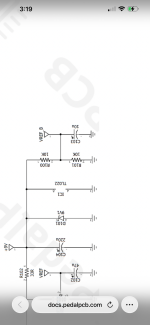

Check your voltages on q5, and check is both sides of c16 have continuity with ground.
All three of these things would be effected if that pot is grounding out. And all three are in the chorus portion of the circuit.
Awesome. It started producing chorus in the box, but then started to gradually fade out to just dry after a few minutes. All LEDs are flashing as needed.
Laundry is calling my name, so I'll check those spots for continuity soon!
Here's what I've got on Q5:
Emitter - .912
Base - 1.44
Collector - 8.94
One side of C16 is closed and beeps (the left leg, as you're looking at the populated board), and the other is open.

I'm not getting anything from Q3. No change with a different transistor.
I'm getting dry signal on Q5's base, but nothing on the emitter. I swapped a different transistor, but it had the same behavior.
I'm also getting a dry signal from pin 7 on IC3, but nothing on pin 3.
