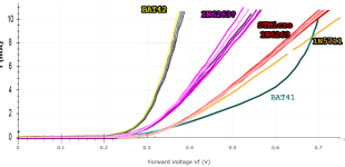

This is updated from last time, and sort of cleaned up. I ordered a number of STMicro made 1N6263 diodes and tested them against what I've got on the breadboard first, then it got my head scratching. I compared the two (the unlabeled, magenta-indicated and branded, red ones) and the curves are quite different. I then went back to IV Bench and shuffled through other Schottky diodes to see if anything might possibly match up, and the 1N5711 looks similar, but not quite.
If one group (Magenta, and it overlapped with whats on IV bench) is 1N6263, and the other group (red) is also 1N6263, is that much difference allowed to be called the same part?
To be clear, the red group is what has been composited onto the other values, which are all from IV Bench.
I suppose I also would like to find the PN of the mystery meat ones, if I can. or just get to the bottom of it all.

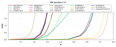

I decided to just do an quick inventory of the Si I've got, and look at a more truncated range.
Looks like the Chanzon ones are about right on with the mystery meat ones at around the ranges we work in.
