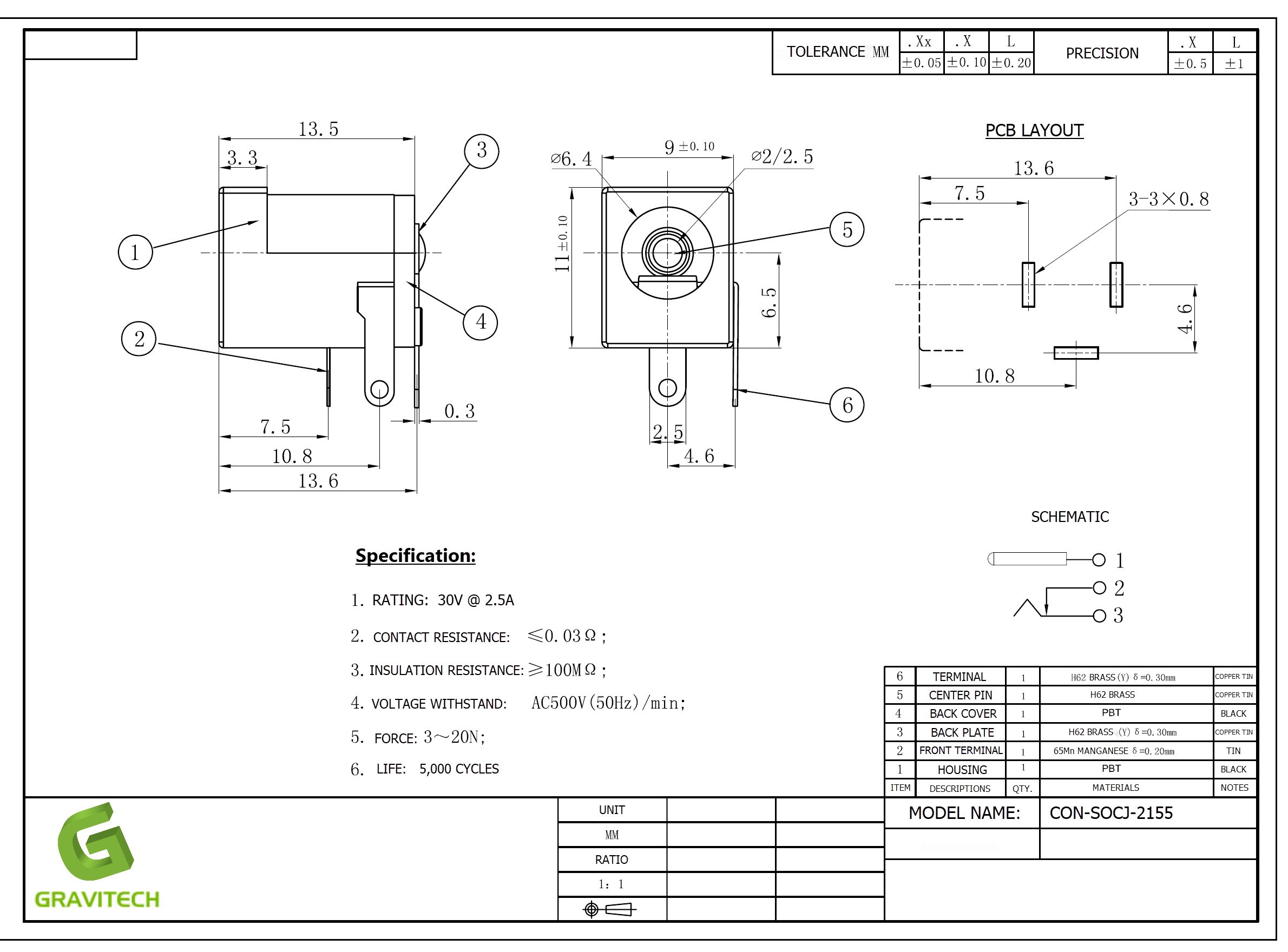

As listed on Mouser-links supplied in the OP:
| JACK 1 (CON-SOCJ-2155) Gravitech | JACK 2 (PJ-002A) CUI Devices |
| Inside Contact Diameter (mm): | 2.1 | 2 |
| Outside Contact Diameter (mm): | 5.5 | 6.5 |
Mouser's link to Jack 1's datasheet doesn't work; however the
link to an image still works: ICD ∅2/2.5, and OCD ∅6.4
It seems Gravitech is no more, as the company's home page is gone.

Inputting the search string "DC Power Connectors Power Jack/Connector 2.1mm x 5.5mm" on
Mouser yielded a possible substitute from
Wurth Elektronik:
WE's PDF DATASHEET
While the connector area (2.1/5.5) matches your needs, I didn't check the specs for the solder-lugs, you'll have to do that yourself and make sure it matches up with your requirements. Lots in stock at Mouser, BTW.
