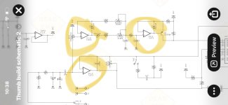

Got this built but when engaged, I'm getting a periodic click once the Ratio control is turned above zero. It does not appear to do anything to the guitar signal. I am unfamiliar with the LM13700 IC. There are several questions beside the original:
1. Which lead should go ito the square pad: Cathode or anode. (I always have this problem).
2. There is no wiring diagram. So I soldered the 1-6 pads on the board to a DPDT ins the 1-6 order. The footswitch does control D1 as I think It should.
3. Where should one start to debug this?
have several Dead End FX boards waiting to be built and this was the simplest.
Attached is the schematic.

One more thing I forgot to mention was that the first time I turned it on it made all sorts of wild oscillating sounds related to the Ratio pot. And LEDs 3 and 4 were flashing in unision with the oscillation. It now only outputs the clicking noise with no flaching LEDs. I have not had a chance to trace the sound through the board.
Update: The LM13700 data sheet says the V+ (single-supply configuration) is 9.5V. By the time the the voltage gets to the PCB through the test rig it's down to 8.6.
Thanks for the help.

I’ll check the I/O grounding but they should be common with the power on the debug rig. I checked the parts and reflowed the soldering. I’ll try some part substitution. I’ve built over 100 pedals and this makes me wary of the other Dead FX I have on deck. They require some really obscure parts. This one is fairly simple.
I buy most common parts from Tayda.
Before I get back to this should the guitar signal be traceable through all the various ICs? Or are some sections and pots used to control voltage and current into other sections where the signal travels. I’m not familiar with how this type of compressor works.
Got back to it. I replaced all the ICs and transistors with no change. I also wired up the I/O jacks so nothing going through the debug rig. With no input at all the unit outputs a rapid, periodic thumping noise. With a guitar plugged in I get the guitar and the thumping sound. The thumping noise starts when the ratio knob is turned up from zero.
