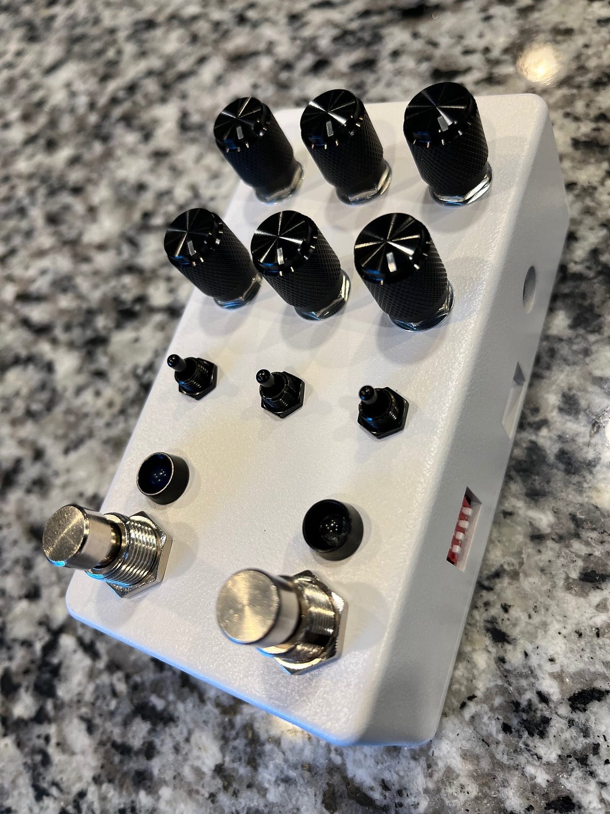

I'm new to pedal building, I started about three months ago and have built around 30 pedals so far. I began with some Pedal Mania boards, but almost gave up right away because my first two builds didn’t work. Then, I switched to Five Cats PCBs and had success, followed by some Moonn Electronics projects. A couple of weeks ago, I picked up about 10 PedalPCB boards and have already built three of them.
I've used this forum several times for information, so a big thanks to everyone!
Lately, I’ve also gotten into stripboard and more diy builds, which led me to discover the Funbox. Most of my builds have been overdrives, fuzzes, and distortions since modulation and spatial effects tend to be more expensive. I thought the Funbox would be a great addition to my setup, so I ordered the boards from pcbway and I gathered enough materials for three builds and completed my first one yesterday.
The build process was straightforward, and the instructions were clear, thanks a lot for that. I assembled everything, loaded the software onto the Daisy Seed, and it worked! but unfortunately, there's a very loud hissing noise throughout. I used the latest components and also tried a TL072, but no luck.
I’m not experienced enough to pinpoint the issue. The only deviation I made was using stranded tin wire instead of the recommended solid core wire, but otherwise, I used all the correct components. The hissing occurs even when the pedal is bypassed, though it gets significantly louder when engaged. I’ve tested the Earth, Mercury, and Neptune modules, and all have the same issue, so I don’t think the Daisy Seed is the problem.
Any ideas on what might be causing this?

I'm actually using the Funbox PCB, not the Terrarium. To be honest, I had already checked out that thread, but the noise in those examples is quite different from what I’m experiencing.
The sound I’m getting is more of a high-pitched feedback with a bit of underlying noise, kind of like a hiss, which is why I described it that way. The Terrarium examples have a more typical kind of noise.
I’ve socketed all the ICs and tried swapping in three different ones for each position, so I’ve ruled out damaged chips. The feedback is still there regardless.
I’m planning to record a video of the sound tonight or tomorrow, maybe someone will recognize it and have some insight.

@Cwallmeier Thanks for emailing me, I wanted to respond here as well in case anyone else is getting more noise than expected. Based on the recording you sent me, you are getting much louder noise than the typical daisy seed build, although it sounds similar to the 1kHz noise (based on samplerate/blocksize of the Daisy Seed), although I noticed your sample had a peak at 500Hz.
Anyway, it sent me on an investigation of noise levels on all my Daisy Seed based pedals, and some things that may help mitigate it. Get ready for a long post with alot of graphs!

Here is the Funbox, in digital bypass mode:
As you can see, the 1kHz noise is present at around -15dB, with harmonics continuing at 2kHz and up. You can predict this noise by calculating how often the daisy seed processed a block of audio. In the Uranus effect, I'm using 48kHz samplerate with a blocksize of 48. So you do samplerate/blocksize, 48000/48 = 1000 Hz. Unfortunately it is audible while not playing, and I think it's safe to say this is an expected baseline for the Funbox circuit. It's a through hole digital board, and the components are tightly packed. Not ideal, but I think that's the reality of the circuit I designed.
Next, here is the Funbox with the Uranus effect active (but no sound coming from the guitar, so this is only noise from the Funbox):
The noise profile is similar, but the peaks go above -12dB. Ouch!
Before moving to the other pedal hardware, I'll show some ways I was able to reduce the noise, but there is a trade off.
By changing the block size and/or samplerate, you can push the noise out of the audible spectrum (above 20kHz). First, I tried reducing the block size to 4. This changes the noise equation to 48000/4 = 12000Hz. Still audible, but interesting to see the result:
This is much better! But that 12kHz spike is still too loud. Also, as Uranus is currently written, the Daisy Seed was not able to keep up with processing, there were audio dropouts (clicks).
Next, I reduced the blocksize to 2, knowing that the Daisy Seed wouldn't be able to run the effect smoothly. 48000/2 = 24000Hz, and as you can see from the graph, the noise spike is not present.
There's another part to the equation, which is the samplerate. Unfortunately with the current libdaisy (unless I'm mistaken), the only samplerate above 48kHz available is 96kHz, which also makes the effect more difficult to process for the Daisy Seed (double the samples to process in the same amount of time). So this time I tried 96kHz samplerate with a blocksize of 4, so 96000/4 = 24000 (same as previous). The resulting noise profile was pretty much the same:
And as before, the Daisy Seed was not able to keep up without audio dropouts. However, it wasn't terrible, so I think if the Uranus code was reduced to use less granular particles, it would be able to run smoothly at either the 96kHz/4 blocksize, or the 48kHz/2 blocksize. Some of the other modules may have similar performance, but others (like the neural net based ones) would be impossible to run at those rates.
To summarize, the Funbox is a bit noisier than I realized. I think the component quality plays a factor. I'll also take more care when writing the algorithms to push any noise spikes out of the range of hearing, and maybe look back at planet modules to see if I can improve the noise profiles. If you get louder noise than what I'm showing above, there may be other issues with the build.
