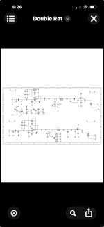

Heres how I do it. Basically create a schematic then double it. Then I create one large pcb layout.
