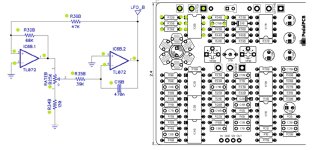

So the kit requires x4 .47j63 capacitors, but I received only 2 with +2 extra .1j63 in the package.
So, hypotetically, I could still complete the build if I put the two extra .1j63s in the remaining two .47j63 slots. Do you think I can proceed, or is there a risk of creating a black-hole-universe-destroying explosion?

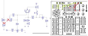

Haha, bro, I'm all too familiar with this situation. When you're building your own stuff, problems can happen anywhere. Let me outline your troubleshooting steps; start with the most likely areas:
Unsure about the resistors? There are many resistor color code calculators online. Check the diagram to see if you've installed them correctly.
Don't solder that .1 capacitor; it needs to be a 470pF one.
Completely cover the photoresistor and LED area. Ambient light can affect its operation, so it's best to check in the dark.
Shine your phone's flashlight on the photoresistor. If there's a frequency sweep effect, the circuit is basically fine.
Use a multimeter to test the two potentiometers to see if they're touching the back of the PCB.
If possible, test the voltage at key points, especially pins 4 and 8 of the IC.
