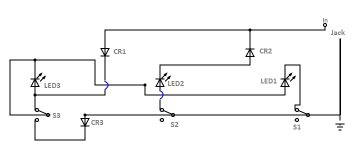

This is my first time taking a schematic and making a Vero from it. Super simple circuit, six diodes and three switches. Three of the diodes are LEDs and they need to be red or yellow for the proper voltage to work with the amp. YMMV with other LED colors. I could get a blue LED to turn on once, but just once. Anyways, the fender three button footswitch that comes with the amp is quite expensive. Also it's quite bulky for a modern pedalboard and doesn't attach easily either. So I stuffed it into a 1590B vero and it works perfectly and I'm so freakin happy about it!
