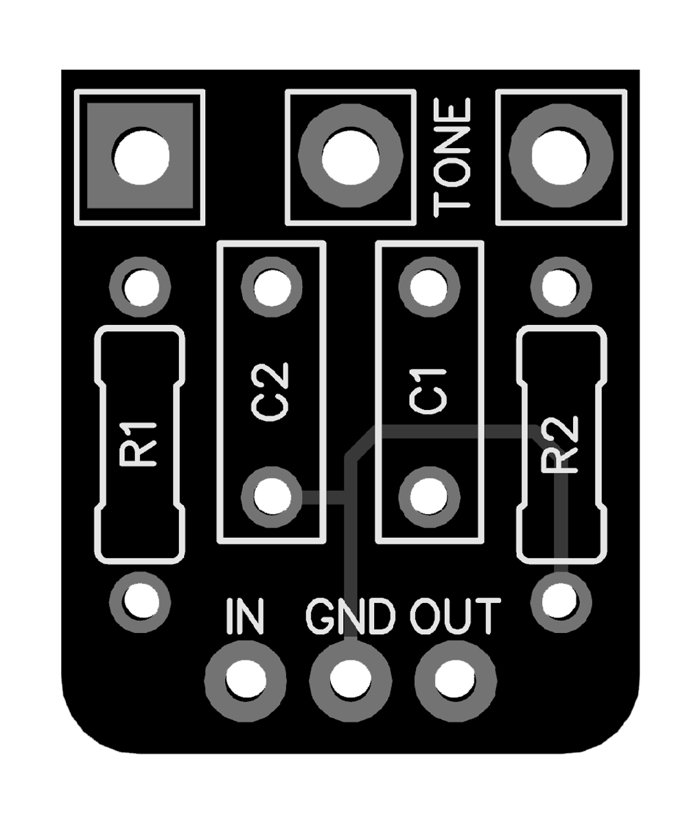

Hey guys. I recently built the SiliSmile PCB. Sounds great! But……….. it would be REALLY cool to add a tone control knob. Or maybe there’s a PCB that already has a tone control on it? Is this even possible or would I need another transistor maybe? I’ve tried a few different fuzz pedals, and the SiliSmile seems to be the fuzz I’m looking for, but would be really cool to control the tone with a separate POT. I thought the fuzz war, or Bellum MK2 might cover that, but doesn’t have the same warmth as the SiliSmile PCB. Hopefully this all makes sense. Thanks!

I’d be interested to try this one before tacking on something at the end. You aren’t going to really get more of any frequencies without an active EQ, but you can get less! Kinda works out the same sometimes 😂
Looks like they’ve taken a few caps and a pot and put it around R4 on the silismile. Worth a try!

This looks very interesting and simple! Maybe I'll give that a go. I think I have everything on hand for that. Thanks for all the insight!
If you do add the Muffin Crumb TONE PCB, then follow that with a MUFFIN CRUMB AMPLIFIER stage to recover lost volume.
You could also add a cap and potentiometer in parallel to the input cap, or the output cap — or use a dual-gang pot and do both!
