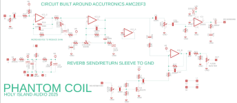

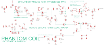

Reviving an oldie, because of a Holy Island Audio pedal being linked to in another thread. They sell DIY boards for "dirty lo-fi reverb" to be used with spring reverb tanks. Out of stock, but something to keep an eye on for those looking into this thread in the future.
Update: He currently has no plans on restocking them. (One can wish for someone to clone it from the schematics below!)
Nice for him to add, what I think is, a way to match tank impedances with any thank you might have got laying around? Though he says in the video that it should work universally. Also pointers on slight mods in the video to suit your own taste.
Current PCB schematic (broken, seeing IC2_A floating around by itself).
Store: https://holyislandaudio.bigcartel.com/product/diy-pcbs
