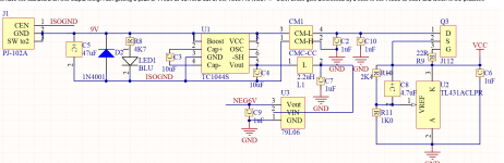

I have a very high-pitched noise, a shrill whistling sound, faint but present to the ear. It sounds like a TL072 oscillation, HF noise. However:
- the noise persists (less loud but persists) when I remove all the TL072s
- it disappears completely when I also remove the TC1044s
The phaser works well, but this noise is present and can be heard. It remains present even without a transistor, LFO, LED, etc. It is not generated by the send-return (I'm currently testing it in a Denon mixer). When I bypass the phaser, it reduces considerably but remains audible.
It is only present with TC1044-A or with TC1044-A and TC1044-B, but it is not present with TC1044B only. I have tested different TCs, the problem is the same. I have already assembled this PCB and I have never had this problem...
I don't have an alternative to test the power supply yet...

I use same wire for every pots... Now I have removed all the potentiometers, and If I unplug power supply during the HF noise is produced by TC1044, I can hear the noise disappear like an engine turned down, from the pump turned down maybe. But I Dont understand why is so present....

Ok so, I solved my problem but I would like to understand why lol
I didn't have a second 9v DC power supply to test, so I did all my tests with the same power supply... As I said previously...
So first I tested a 12V power supply, and immediately the pitch of the TC1044 charge pump's RF noise changed; it became less high-pitched (and therefore less noticeable), and a little quieter (less noise gain). So I tested a second 12V power supply, the chippest lol, by the way, and bingo: zero noise.
Why can power supplies indirectly produce noise that they don't generate themselves in this specific case?

Edit : So the TC1044SCPA in this pedal is is sensitive to power disturbances... and this circuit seems to work well under 12v, no noise

TC1044SCPA is rated for 12V maximum input voltage. I would advise against running it that close to max specs continuously.
Also, not all power supplies are created equal. If the external power supply isn't filtered well, that noise can get into the pedal circuit. Also, running the charge pump on higher voltage can increase its switching frequency to where it isn't as audible anymore, although you say the whine became less high pitched, so it may very well just be poorly filtered external power supplies.
I was wondering about that. I had a phaser build that drive me nuts until I finally tried a different one.
Some power supplies are just noisy. I’ve found optical phasers to be sensitive to thst.
