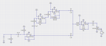

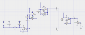

Hi Guys! I tried to make the scenario preamp work on LiveSpice. Fig.1 is working loaded and tested as plugin pedal on DAW *i use generic opamps. But when i try to use other opamps like op134 , it doesnt work when i try to add the gain stages but it works when i bypass it. Fig2 vs Fig3. Should i just use single generic opams? considering tl072,opa2134 are just 2 opamps inside. Thanks! silently enjoying LiveSPice and LTSpice! Thanks @temol for mentioning this app! love it.
Fig.1
Fig2
Fig3

Live spice doesn't like overly complicated circuits, you sometimes have to split things up.
Ive found issues in the past with specific opamps if they're not powered with +/- supplies.

Thanks! I tried to reduced the oversamples and now it works. I just want to make a preamp that i can use on fx loop. i want to push more the power amp section, thats the reason i want a higher headroom so it will not just distort early on the front.
Thanks! I tried to reduced the iteration and now it works. I just want to make a preamp that i can use on fx loop. i want to push more the power amp section, thats the reason i want a higher headroom so it will not just distort early on the front.
