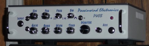

What chassis and what transformer, please? My expenses have always been quite a bit higher than that!

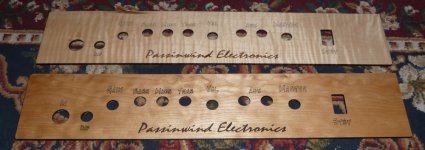

Now that the weather is cooling down and I can finally get back in my shop, time to put together that 100 watt bass amp I mentioned.
Proof of concept power amp build, which I ran for around six months with a wide variety of tube and SS preamps:
Basic Europly case config:
I have a grill screen from Reliable Hardware and some matching bocote side pieces, and then a variety of laser etched test front panels:
I think my luthier friend still wants to take another crack at the front panel and probably do something more uptown than plywood for the shell though. He will probably end up owning this build in any case, assuming he comes through with the acoustic guitar we've discussed building.
All that that looks beautiful.
The chassis I've settled on for anything with 4 or more tubes (or just complicated) is this one here:
Steel and very roomy for a preamp at 16x8x3".
I misspoke, $36.07 each. That's the price break for 5, but it does include shipping (drop shipped directly from Hammond).
I also have used some of the 17x4x3" ones too, but re-work is not fun in them. I have a couple left, I might just put some SS preamps in them (Sunn Beta? Music Man?).

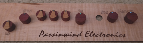

Not to sound awkward, but nice knobs, bro. :)

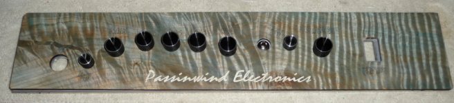

Artwork done for one. The metal Brutalist knobs... that's my knob of the decade. Feels good, looks good.
It's rewarding to see this stuff come together but man some of this hobby of ours is what I would call Fun Type 2 (tm). Like winter camping on the North shore of Lake Superior. In the moment, painful, but the experience and end result is worth it (mostly haha).
Artwork looks good!
Hey they look good! I have been using mostly the same knobs on everything. Small version for pedals, large for amp. They are pretty cheap, are made from Aluminium and have a hex screw lock. But these might be calling my name for my next build.

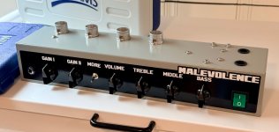

I finished up the art work for the Deliverance preamp yesterday, I actually had to start over after I couldn't recover from it being miss aligned when applying it to the chassis. It was a bummer. Anyway, the final result makes me excited. I love the how the stealth chicken head knobs and green power switch look.
Anyway, now ready for the soldering iron again! Starting on the AOR preamp today. This is my favorite part. I love seeing the interior chassis in this state, doing the heaters, wiring up the transformer etc.

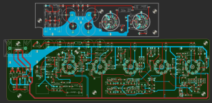

Also, I think I am done with my PCB for the VH1+3 thingie now.
All traces are generously dimensioned for what they will actually carry and the creepage is fairly conservative everywhere (read: 3mm+, high voltage is 5+). Long tail PIs are not fun to layout, and selecting to have one tone stack per channel could have spelled the end. But it fits. As last time, that's one board for the Poweramp (5x20 cm) part and one board for the preamp (33x10 cm). Should fit in a small headshell. Criticism welcome!
Next steps are ordering the Farnel RED inductor to make sure I have the right data on it for the footprint, figure out some details for the parts (which switches etc) so I can order everything to be able to double check footprint before ordering PCBs at JLCPCB (and receiving 5 because that's the minimum order size.
