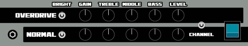

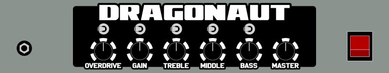

The other one I finished layout for is the Laney AOR:
This will cover the 6 knob MV AOR Matt Pike used but also the AOR gain stage some of the other models had will be toggle-able (overdrive here).

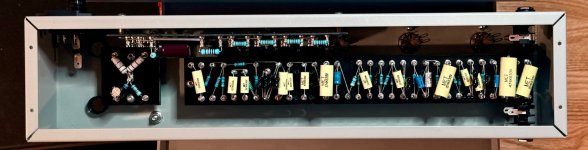

Just noticed this thread. I have a DIY 4 x EL34 bass amp build that’s been languishing for about five years now, hopefully one of these days I’ll finally get back to it. I don’t do clones anymore, but here’s one of my older original design rack bass preamps using one 6SL7 and a pair of 6SN7s in Aikido format:
The “new” amp will use a similar front end, but one 12SL7 and two 12AU7s. All the daughter boards are long since stuffed and ready to go, it’s a mishmash of PCBs and little turret boards. The power section is a repurposed NOS commercial PCB with a transformer splitter/driver section, which sounds really great for clean bass. I bought several of these boards, plus the matching power trafos, a few are 60 watters with just two power tubes. Could be trade bait, I’ll certainly never use more than a couple.

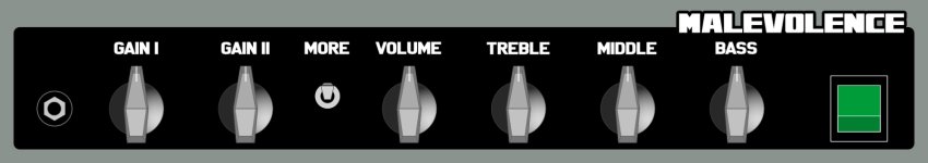

For the XR88R I'm going to do it in the larger chassis so I'll have room for relays , that said since I'm only doing the two channels, and I really only play for my cats and dog, I'll probably just use a DPDT toggle. Here's my tentative panel art:
