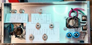

Working my way through the Model T turret board and the chassis layout...
I have rectifier board, bias board, heater humdinger and elevation board left to go.
Considering where to put the bias test points and bias adjust pots. I had thought on top, but I have all that space on the back panel...
