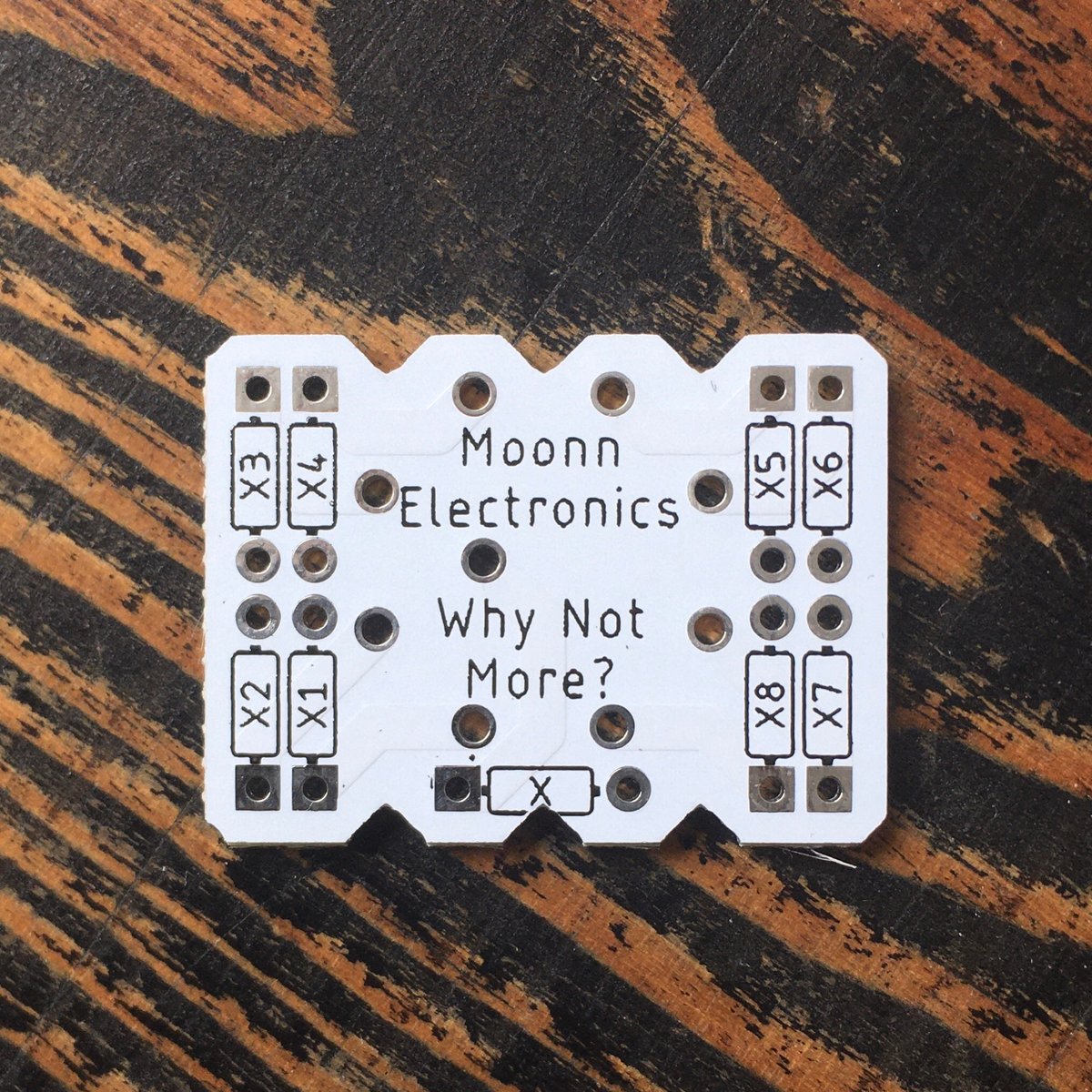

Hi, I'm going to build a DOD 250 (distortion 250 from Pedal PCB) and I want to add a rotary diode switch in there so I can try different flavours of distortion. The problem Is I'm not sure how I would do this. Can anybody help?
I assume I could use something like a 1P8T Rotary Switch. The part of the diodes connected to ground are connected to the pole and the different legs of the rotar switch are connected to different configurations of diodes? Am I on the right track?

How many options do you want? There's 4-clipping-options 2P4T-PCBs available from GuitarPCB, MAS Effects, Moonn, Fuzz Dog, RullyWow (or was it Delyk? or both?) and others.
You could always solder the diodes right to a switch, with many more options.

Probably an obvious question, but if I use one of these I should be able to get 12 clipping options right?
I might buy one on the weekend and try some clipping options on perf board or breadboard.
I've tried a 3pole 12 rotary switch, but that only allows 4 options (but combinations if I connect the poles).
