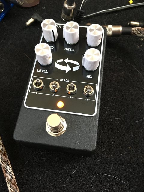

Belle Epoch going on Reverb. Love the Hydra.
A few notes: squeezed in film caps and used PPCB relay switch. 'Pro' momentary switches from LMS feel great.

Looks super nice! How did you mount the intelligent relay board on the footswitch?
It's not attached to the switch at all.
I soldered a header on the effect PCB and installed everything in the enclosure. Then I put in the momentary switch and bolted it down. Relay board went in last and soldered to headers so I would be sure it was clear over the switch.

I built a simple PT2399 delay, but I'd like something more modern like that, with the FV-1.
I just afraid to solder it on the PCB. Is it hard to solder it?

Fortunately, when Bugg has them in stock, you can select the option for him to do it for you. I'd really recommend that if you're not experienced with SMD. With the right tools, it's not hard at all, but better to practice with parts that don't cost so much.
Also, this thing sounds so great, I set my PedalPCB relay bypass to default ON. Best relay switching solution I've ever used and it's not even close.

Updating with a mod that's working really well for me.
I didn't have any use for the mix knob being higher than 1-2ish, so clipped pin 3 of the mix pot, leaving the clean-though at 100% at all times.
