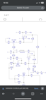

Hi! I just build this Karaoke Chorus kit (based on Boss CE-1), but it’s not really working.
I can hear it doing a chorus effect, but it’s not moving, the rate is just flat. When I turn the pots I hear the chorus, but it’s not making a chorus sound on its own.
Also, the vibrato does work, but only very fast. It doesn’t change in rate when I turn the vib rate pot, it just fades out in volume.
The rate led also doesn’t move. It’s just always bright on (on chorus and vibrato).
I soldered it as nice as I could and payed triple attention to all components that I installed.
Does anybody know where to look or what voltages I should search for etc? I can’t find a lot of trouble shooting pages about this pedal..
Thanks!

You should start by checking the parts in this area. Make sure the resistors are correct (and not 220 ohm instead of 220k for example). Then check caps etc.
It sounds to me me that your lfo isn’t working so the problem will be in the area n the picture.

Here are some voltages from a clone that I made. Based off the same schematic but I made my own pcb. Just the lfo and the clock bit based on your description I think your problem is here.
Maybe you could post you voltages here for all ic and transistors and we can check for you?
