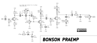

Years ago I saw posts in a DIY pedals Discord Server from dylan159 about a redesign/optimization of the Beson Preamp circuit, which he titled the Bonson Praemp. Actually, the joke is that the name changes every time you refer to it, and you can't call it a preamp, so it's also been called the Bonsai Praemp, Bunsen Permp, and a slew of other names that follow in the footsteps of the Benedict Cumberbatch name meme, but I'll refer to it as the Bonson Praemp here, since that's the title on the schematic that he published on the discord server and on FSB. The biggest changes that dylan159 made to the circuit have to do with the Bass control, and sclaing the impedances of the section to do away with the terrible B2M pot used in the original circuit, but there are a handful of other tweaks and optimizations that impact the overall character of the circuit. For further reading, you can check out Dylan's own thoughts and explanations regarding the changes he made over on the FreeStompboxes Forum. Schematic embedded below for any of y'all who aren't registered over at FSB:
Anyway, I figured I might as well build this Korkie enlosure and Son Of Ben pcb to Dylan's Bonson specs to see how they compare. Conveniently, at some point in the past I had this idea already, and back then I already did the legwork of noting all of the changes to the circuit as well as annotating an image of the PCB with the revised values, so putting this one together was a breeze–– No more difficult than building a stock Son Of Ben. Below are a jpeg of the modified board layout, as well as a table of the component values in relation to the PPCB Son of Ben RefDes. PM me if you want the full-res PDF version of the board or the .xlsx file for the table.

Like the two benson clones, it has a switchable charge pump for 9/18v operation. Some notes:
- it generally just sounds better
- it’s a lot louder
- the bass pot is a lot more dramatic in it’s effect, compared to the original circuit where it’s a lot more subtle outside of the upper and lower extremes. That said, with the bass pot cranked, it isn’t quite as woofy/flubby/subby as the original. I see this overall as an improvement, however I do find that characteristic of the original to be beneficial when using it on bass as a preamp to feed a power amp.
- the difference between 9v and 18v is quite dramatic on the bonson praemp, while virtually indistinguishable outside of a few subtleties on low gain settings for the original circuit. For one thing, there’s a noticeable boost in output at 18v that’s not there in the two stock builds.
The bias of the JFETs also shifts pretty dramatically, which I haven’t noticed on either of the original circuit ones I built. At 9v The drain voltage for Q1 is ~5v, and I biased Q2 and Q3 to 4v. At 18v this shifts to Q1 13.35v, Q2 12.25v, Q3 12.3v
I can’t remember off the top of my head, but I think in the two original ones the voltages scaled mostly proportionally. I think one of them was something like @ 9v: Q1 4.6v, Q2 4v, Q3 4.1v; @ 18v: Q1 10.6v, Q2 8.5v , Q3 9.1v (I'll take specific measurements at a later point and update this section)
Of course, I’d probably chalk this up to differences in the specs, since I just picked 3 random 201s out of my bin each time without checking them out. At some point I might do a comparison swapping out the FETs in each of them and rebiasing to see what if anything changes as far as the 9 vs 18v operation.
