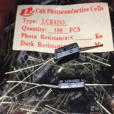

With regard to the pitch witch/pitch pirate dlx, I built one up last night and used a random aliexpress vactrol instead of an LED/LCR combo and it seems to work perfectly well.
I used one of these:
I don't really have much faith in whatever might be on that datasheet so I'd just take it as a pass/fail binary situation and in this case it passed.
