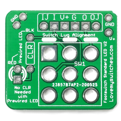

Hey guys, I'm working on a procrastinator kit and I have a bunch of 3PDT boards from love my switches I would like to use up but I'm a little confused how to integrate it into this kit, particularly where to solder SW but honestly a little uncertain about the whole thing. Can I leave the LED off the main board and move it to the switch board? What would I hook v+ to?
I have LMS's pre wired LEDs so the resistor is already taken care of. Just to make sure I'm following, I can jump the - from the main board's LED spot to the pad just below where CLR is marked? For the positive side it looks like it traces back to v+, so nothing else should be needed right?
If that's the case, you can install that led at any of the 4 CLR or LED pads, whatever is cleanest and easiest(mind polarity, whichever side goes to SW is negative, V+ is positive) then jumper the remaining 3 pads.
What happens at the daughter board/3pdt is the connection to ground is switched. The led is always connect to V+.
In your situation, the path is CLR, led pad, SW to V+, daughter board CLR, daughter board led pad, 3pdt switch, ground pad.
