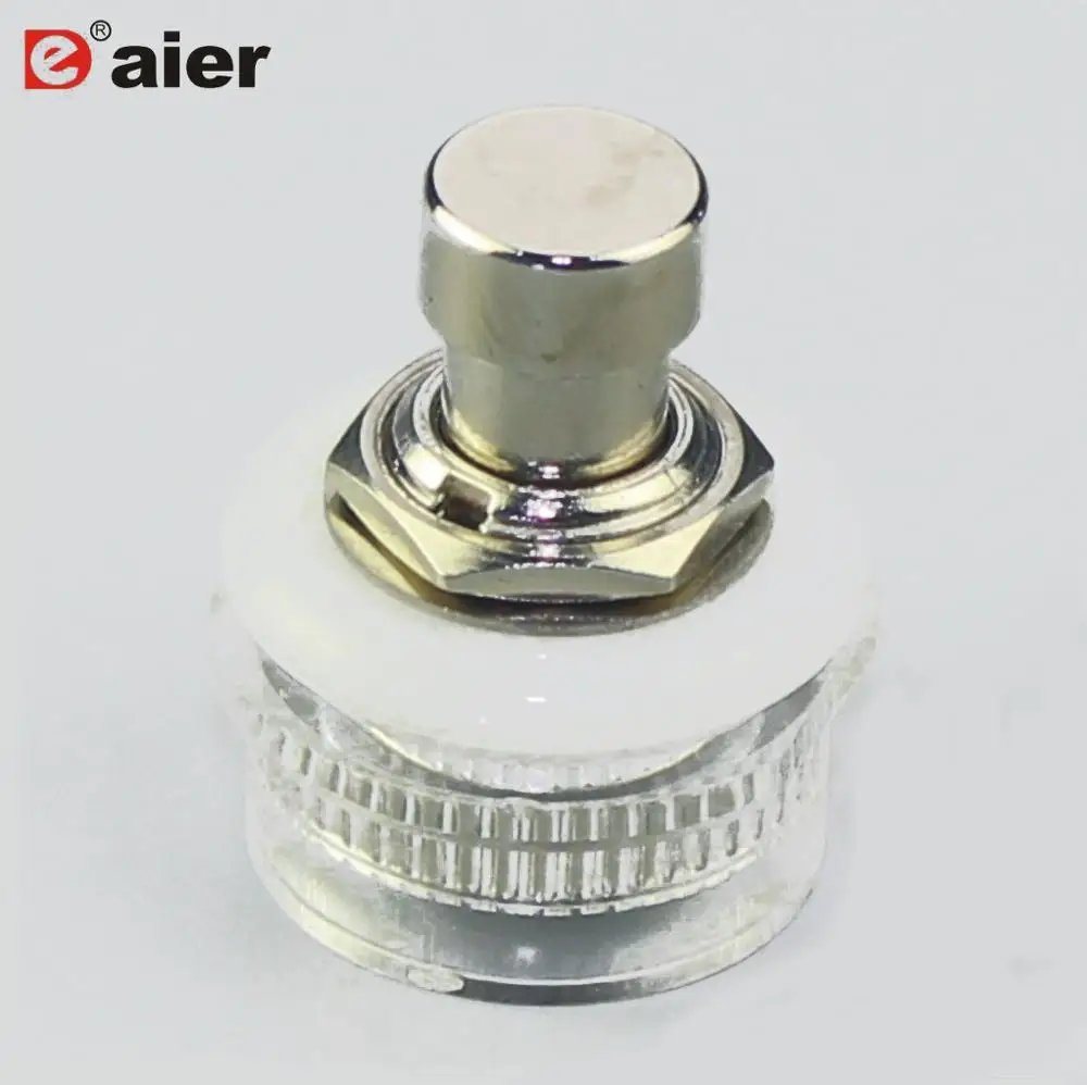

The actuators are a bit pricey and hard to find in the US. Digikey and Mouser have some but $$
Some time ago acutators were available on aliexpress, but they evaporated. And so far no offers, I check regularly.
I bought mine from the link I posted above (Banzai Music in Germany). They're about 2 Euros a pop and shipping to Canada is around 9 Euros. I didn't find that expensive at all, but I did buy a couple dozen, so shipping became negligible.
I wonder how this last one installs in a pedal. Looks like it needs a huge hole for the plastic piece, but allows LED lighting. Intriguing...
Kinda looks like the same as the others with an added clear shroud
