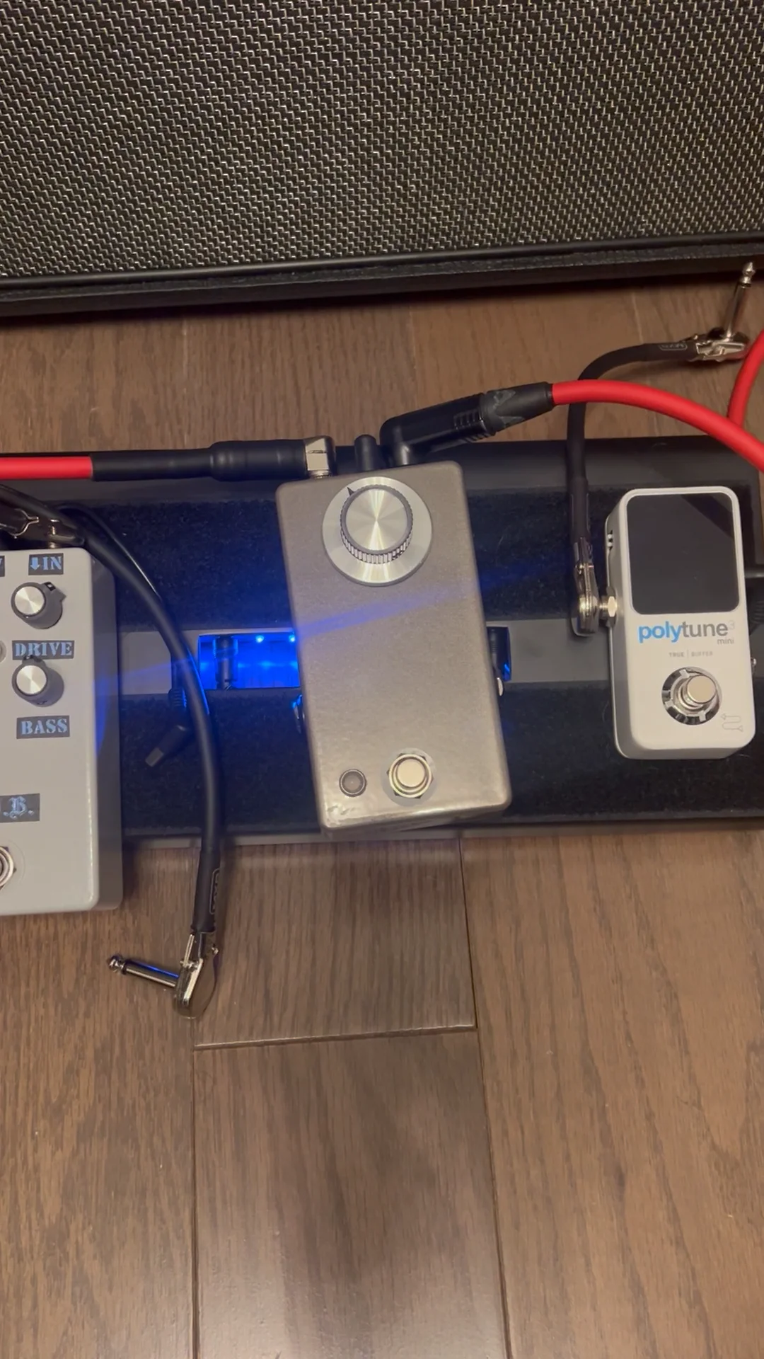

Hi all! I finished up a Muzzle (Classic) build this past weekend. The pedal seems to work as intended but I am getting some crackling and fizzy sounds when the input signal is crossing below the pedal’s threshold setting. This happens with the four cable or the two cable method. The noise happens even when the threshold is fairly low and you allow the input signal to sustain and decrease till it reaches the threshold. The noise only last about 2 seconds, or until the signal fully crosses below the pedal‘s threshold setting. Anyone else experience this and have any input on what the cause could be?

That is weird… taking a closer look at you pic I believe that TL072 might be a fake so swap that out and see what happens… would be an easy swap just to see.
I got the TL072s in a pack of 12 of Amazon. I wouldn’t be surprised if they are fake. Haha I’ll try some of the possible solutions provided by the collective and report back if any of those things are the culprit. Thank you!
Don’t buy parts off of Amazon unless you know 💯 they are a legit source, they are almost certainly counterfeit
Well this is embarrassing. It looks like a counterfeit TL072 is to blame for the noise. I changed it out for a genuine TL072 from another pedal, and the crackle is gone. It also raised the threshold sensitivity significantly. Lesson learned, source parts from a reputable dealer. Thanks everyone who contributed to troubleshooting and @Paradox916 for spotting my bootleg IC!
