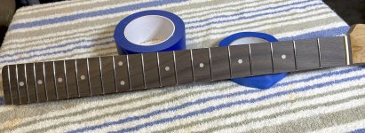

It's a nice piece of wood but there's a couple of mineral streaks on the headstock which makes me think these may be blems.
Check out how well the fret ends are dressed, that's better than I can do myself.
The board has some nice figuring...
I'm planning to do a Danish Oil finish on the neck except for the headstock. which will be a gloss nitro.

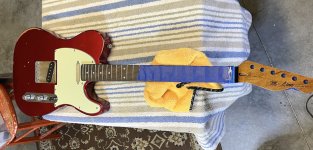

Couple more shots of the mostly finished body.
And a couple of mockups of how it would look with this roasted maple neck.

4-11-23 Update: Strung her up! Woohooo!
The only thing I was still missing for this guitar was a set of saddles. Welp, turns out I HAD a set of Gotoh In tune saddles in my parts box, buried way down at the bottom.....:rolleyes:
So strung it up today.
Yesterday, I finished the back with 4 coats of Danish oil and let it set up overnight. Then applied a coat of carnauba wax for a little extra protection. Neck feels great, like a tung oil finish but without all the hassle.
I also rolled the fingerboard edges, but I think I'm going to have to roll it a bit more.

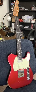

And here she is all strung up.
The pickups are my first experience with Wolftone F-style single coil pickups.
They sound different from my tried and true Lollars. Not better or worse, just different. A little "stringier" if that makes sense.
They actually sound a lot like Fender CS pickups. Whereas the Lollars seem to have a bit more body and mid-range.
I'm actually liking them a lot so far. I need to dial up some optimal amp settings for this guitar yet.
So as I've mentioned in my other builds, the guitar needs to sit under tension for at least week or so before doing a final set up.
I have not touched the nut yet, it's close but it needs some slot widening and lowering a skootch.
I did not touch the frets on this neck, it plays incredibly smooth and the fret ends are well "hot dogged" (as per @Gordo :ROFLMAO:)
I did an action set up to my preference and intonated the saddles. It plays like "buttah".
