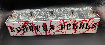

Let's wrap it up for now with the most challenging build I've done thus far.
Another Aionfx board, the Neurotron Ring Modulator.
This thing is a behemoth of a board, and you REALLY have to pay attention to the details with it's build.
However, when you have it done and it works, it's such a rewarding pedal with a TON of possibilities.
As for the enclosure, i thought back to my time working in the drilling industry and seeing countless industrial control boxes that were always beaten to hell and back and stained from the greasy and dirty hands over the years.
So, that's what I wanted to try to replicate with this on.
With the liberal application of sandpaper, an xacto blade, and thinned out black paint, I completed what was also my very first aging/weathering project.
The label, I just had fun with, so check out what it says on the sides and bottom center. PXL_20260418_210438917~2.jpg PXL_20260418_210450507~2.jpg PXL_20260418_210500498~2.jpg PXL_20260418_210517670~3.jpg PXL_20260418_210636216.jpg
