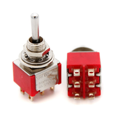

Does anyone know where I can find out which type of DPDT switch the Carling and Gorva on/on/on switch are? I know taiway ones are type 2, but I don’t have any of those on hand, so before I ordered I wanted to check out the specs on the stock I have, but I can’t find this info anywhere on the google. If anyone happens to know, or know if there’s a list of what manufacturers are what type, I’d appreciate it! Thanks!
Apparently these are not too common... these guys have *one*
It was recently brought to my attention that StompBoxParts now has Type 2 DPDT ON/ON/ON as well.
I just grabbed a bunch of them for myself and can confirm they are Type 2.
Aside from these, the only other brand I know of that makes a Type 2 is Taiway.
McMuster-Curr... Must be a subsidiary of StewedMuc.
PS: @hybridpi — if you really need the opposite Type of the Type you have, you can carefully pry them open and flip the little widget in the bottom around; I've done it with a Type1 Taiway switch to make it a Type2.
I know this is an old thread, but just thought I would update. Tayda now has Type 2 DPDT ON-ON-ON toggle switches. Part # A-5951. I received my order and tested the switches with a multimeter for continuity before throwing one in a pedal. All good! Works like a charm.
