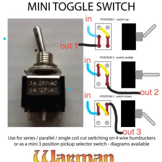

ON-ON-ON Toggle Switch
No, the middle lugs act like 2 separate switches. Referencing the Tayda diagram, you could replace the blue and green side with 2 separate single pole switches. And flip the green and blue individually. (I’m not sure if that helps you picture it or not)
I like the on/on/on idea, because you can organize it for small/medium/large values in logical order as you flip the switch up or down.
The on/off/on wired in parallel would put the smallest value in the middle position of the switch. So you get medium/small/large as you sweep the switch.
thanks for this!!
I've been scratching my head trying to figure out lowest-to-highest on an on/off/on, but didn't even know on/on/on was wired in exactly the way I wanted.
im doing a baxandall with selectable treble and bass freq, so I want them to be in order.
