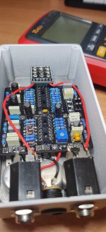

LUG 4 has continuity with SW on the PCB breakout board and on the main PCB itself.View attachment 14246
Like this
I keep forgetting yer new you pick stuff up pretty quickly
Anyway so 3PDT lug 4 continuity with SW and SW should also have continuity with LED K
Lug 5 to ground
And with effect on lugs 4 and 5 should have continuity
This makes ALL the sense now, ha.Doesn't matter it connects the same
If you continuity check the SW pad on the main pcb it should beep with LED K pad and 3PDT lug 4, 3PDT lug 5 to ground and in effects mode 4 and 5 should have continuity
No swearing now, just whack a jumper on if your LM skills are lacking I've got wee clippy wires so no skills requiredthis will be a very tricky feat with liam neeson level skills.. attempting this now.
Jaysus hope you've got yer aviators on that's bright as.......well done to youI made a CANDY CANE hook end out of a SMALLLLLLLLLLLLLLLLL piece of bare wire, SOMEHOW used tweezers and my stew mac tools, SOMEHOW got it in there, somehow soldered it. Keep in mind, I have this PCB and switch DIRECTLY on top of the PCB. This is not an easy access. That was like MICRO SURGERY right there. And guess what!!!!!!!!!!!!!!!!!!!!!!!!!!
THANK YOU MAN!!!!!!!Jaysus hope you've got yer aviators on that's bright as.......well done to you
I guess the question is why was the PCB itself not beeping/continuity from SW to LED K... Very interesting.Jaysus hope you've got yer aviators on that's bright as.......well done to you
You actually had the circuit working first time just no LED indication and for starting out I'd say that's a pretty good record so far
