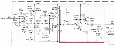

Don't ask how or why, but I was looking at some Kustom amp schematics at 4:00AM 🤪. They are cool solid state amps with interesting circuits from the late 60's and 70's; famous for their tuck and roll upholstery and use by John Fogerty. So as I was skimming the preamp schematics for the, dated 4-70, I saw something familiar:
Hey, that's a Bazz Fuss! It's so cool to find that this 20+ year old DIY classic is actually a lot older.
There's obviously a lot more going on here with the "Harmonic Clipper" circuit. Firstly, it runs on the same dual supply as the rest of the preamp, at +/-8V. Secondly, it is preceded by the input stage providing volume and some tone shaping, including a "Bright" switch. Like other fuzzes, the Bass Fuzz sound relies on being loaded by the pickups. In my experience, it doesn't sound bad after a buffer, but it does sound completely different and a lot noisier. Here, it does have a fairly low impedance output before it. Lastly, it is followed by a buffer straight to the collector and the rest of the preamp stage which I haven't shown. This includes a James tone stack (at least I don't see a feedback path to make it Baxandall), gain recovery, and a switchable "Boost" stage. The switch for teh clipper circuit looks like it toggles two transistors to either mute the dry or the clipper depending on how its set. Here is a link to the full schematic and here is the site I found with all the Kustom schematics.
The transistors are all SE4002 (which Small Bear has funnily enough), except where noted like the 2N3638 in the input section. Standard silicon stuff. I think other transistors would sub fine. That FD111 is a silicon rectifier diode from what I've read.

I checked that out while looking to see if anyone already made something based on this and did some more digging. They found their circuit on a patent from 74’, which first appears in Kustom amp schematics from 71 like the 150 and 250. It’s a hard clipper circuit not unlike the Electra, which is what they ended up using at the center of their design because the patent schematic lacks values.
I’ve since read that Fogerty used a 200 series amp, which are circa 68-70’ and would have had the Bazz Fuss thing in it.
So based on that they got it wrong in the Fogerty sense, but of course I mean no disrespect in that. Their interpretation of the circuit they found is pretty neat, and it was cool to read about their process. As far as I’ve found, any Kustom themed “Harmonic Clipper” pedal ever made and sold is the PJP/D2T design.

The plot thickens, however, as I have found schematics to the Kustom 200A series of amps. The original post shows the clipper circuit of the 200B. Of course, the 200A is completely different, and, of course, John is said to have used a 200 A4, with the full compliment of effects including the clipper, vibe, trem, and spring reverb.
The schematics are dated 67’, and the clipper circuit is not a Bazz Fuss, nor is it the later 150/250 series clipper that they found over at DIYstompboxes. It is two transistors and a diode, and I think it will work by itself. So, I will post it to this thread soon for those of you who like to tinker with vintage fuzzes. I’ll get around to trying it too.
My main goal now is still to adapt the 200B series preamp and clipper to a pedal format, likely using a charge pump circuit to get the +\-8v.

Here is the Harmonic Clipper circuit from a Kustom A series schematic (Fogerty is said to have played the 200A4). These amps were designed modularly, so the effects are on their own board that could be installed and populated depending on the model. The A4 had all the goodies: vibe, reverb, and clipper. Schematic is dated 67'.
I have not tested this circuit, but I plan to and it's here for all you fuzz heads to tinker with. The topology looks like that of a fuzz face at a glance, but it has a few key differences. For one, the second transistor stage is a buffer with the signal taken from the emitter. Thus, it lacks the second gain stage and the bypass cap that make a fuzz face FUZZ. Second, the shunt resistor for the negative feedback from Q2 emitter is 10k, and it's in parallel with a diode. I hypothesize that this circuit works essentially like the Bazz Fuss, with the diode doing effectively the same thing bias and feedback wise.
The circuit is run on +13v in the amp; but I don't see why it wouldn't work at 9v unless the voltage at the emitter isn't enough to conduct the diode. I haven't done the maths :).
