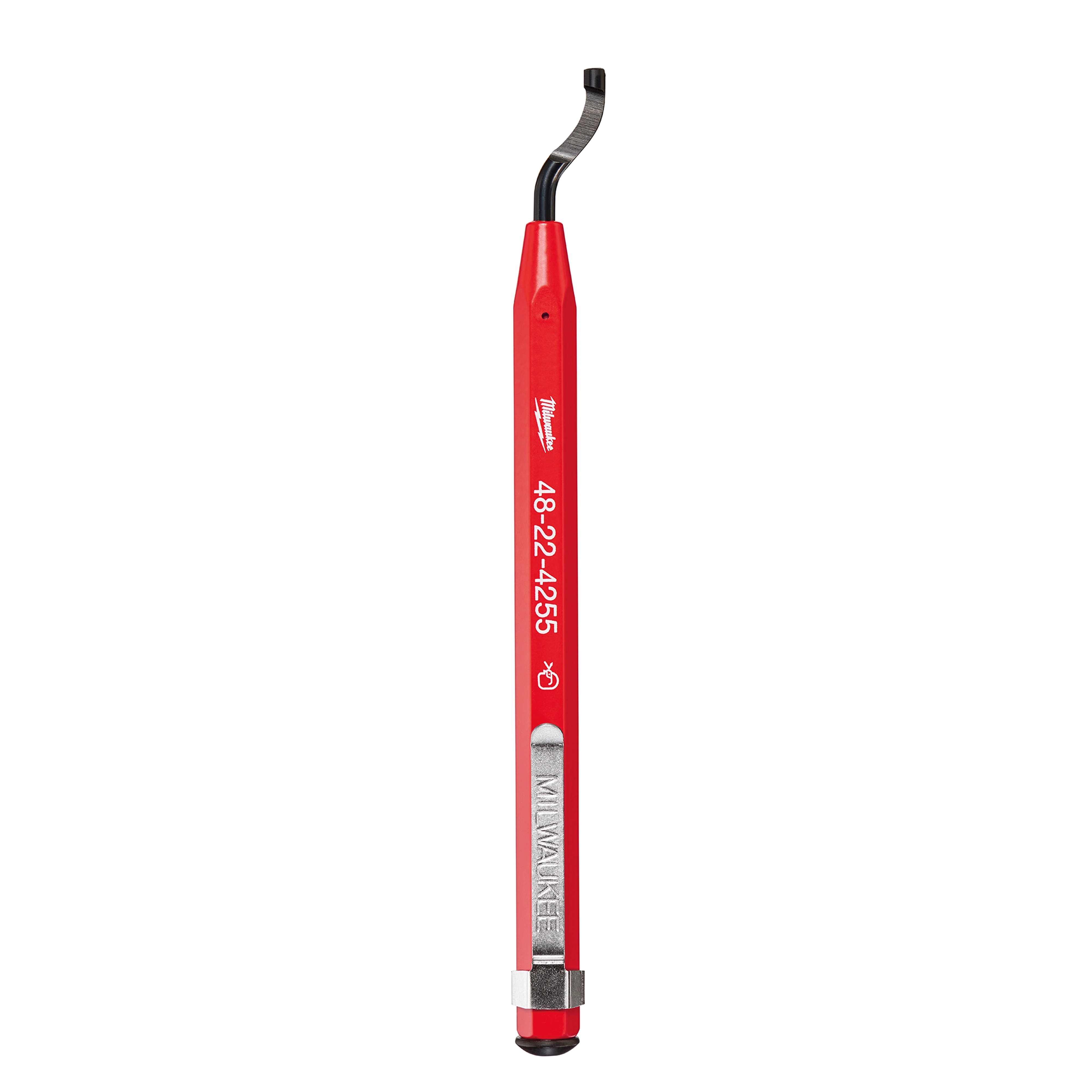

If you don’t have one already, a de-burring tool like this one ^ can be very handy for making little adjustments to slightly misaligned holes.
Works great on soft metals like aluminum, and I find it quicker and neater than using a file most of the time.
I like that idea. In past builds I've brute forced it with a reamer. This would allow you to focus on one side rather than making the entire hole bigger. I appreciate the tip.
Is there a de-burring tool that you prefer that is more effective or more durable than others?
…This would allow you to focus on one side rather than making the entire hole bigger.
Yep, that’s exactly how I’ve used it several times.
I’ve have this generic Chinese one off of Amazon: https://www.amazon.com/dp/B09376DFYP
It’s been working fine.
Milwaukee does make one (they call it a “Reaming Pen”) if you want something with a slightly better pedigree, and red! ;)

I grabbed the one that @pricklyrobot recommended. It has a nice heft to it. It arrived today. Looking forward to putting it to use when I screw up 😁
@pricklyrobot! The de-burring tool that you recommended saved my butt with a toggle hole that wasn’t quite the correct size. TY for the recommendation!
