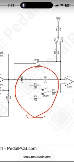

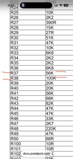

Edit: there may be an issue with R 37 and R 38. I was just reading this thread. Just recently I started following the board unless there was a note somewhere saying it was incorrect. Seems there’s a disconnect between the Pastel board and the build docs but no note on the build docs.

There may be a problem with R 37 and R 38. The pedal PCB board follows the schematic. But the build documents have the two resistors opposite the board and schematic.

That won't make a difference because it just switches between the two values. Only thing it would change is the direction of the switch. It's ok to not like a pedal. Most pedals are disappointing.
