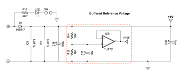

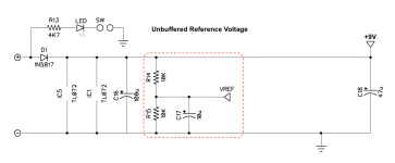

5. If your reference voltage is high impedance (unbuffered), routing it all around the PCB is making one big noise antenna touching every stage.
