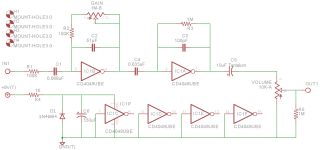

Red Llama kit with treble cut mod
Not seen any "kits" with a treble cut (control) for a Red Llama, but there are several schematics "out there" from which start.
Here's one I found . . . .
If you don't want to use as many of the inverters as this build, just use the standard two, and a third one like tone section in the schematic.
A real Red Llama schematic looks like this . . . . .
Just add the third inverter to an original schema with the tone control between C5 and the Volume pot. Or modify the existing 2nd inverter to match the configuration of the tone control in that first schematic.
