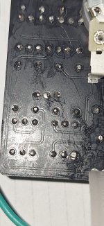

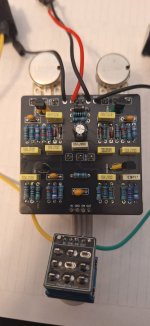

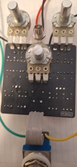

Probing around this board loses signal before the volume pot. I traced it up to Q4 and that's the last place audio is coming through. Just in case I switched out C14 and it didn't work. The pot is working when I test at 52K. Any help would be much appreciated. I've built this circuit a few times before, 3 successful on perf board and once with the pedal PCB board before with no issues.

On Q4, you should have audio on the base and louder audio on the collector. What do you actually have?
What type of transistor are you using for Q4?
