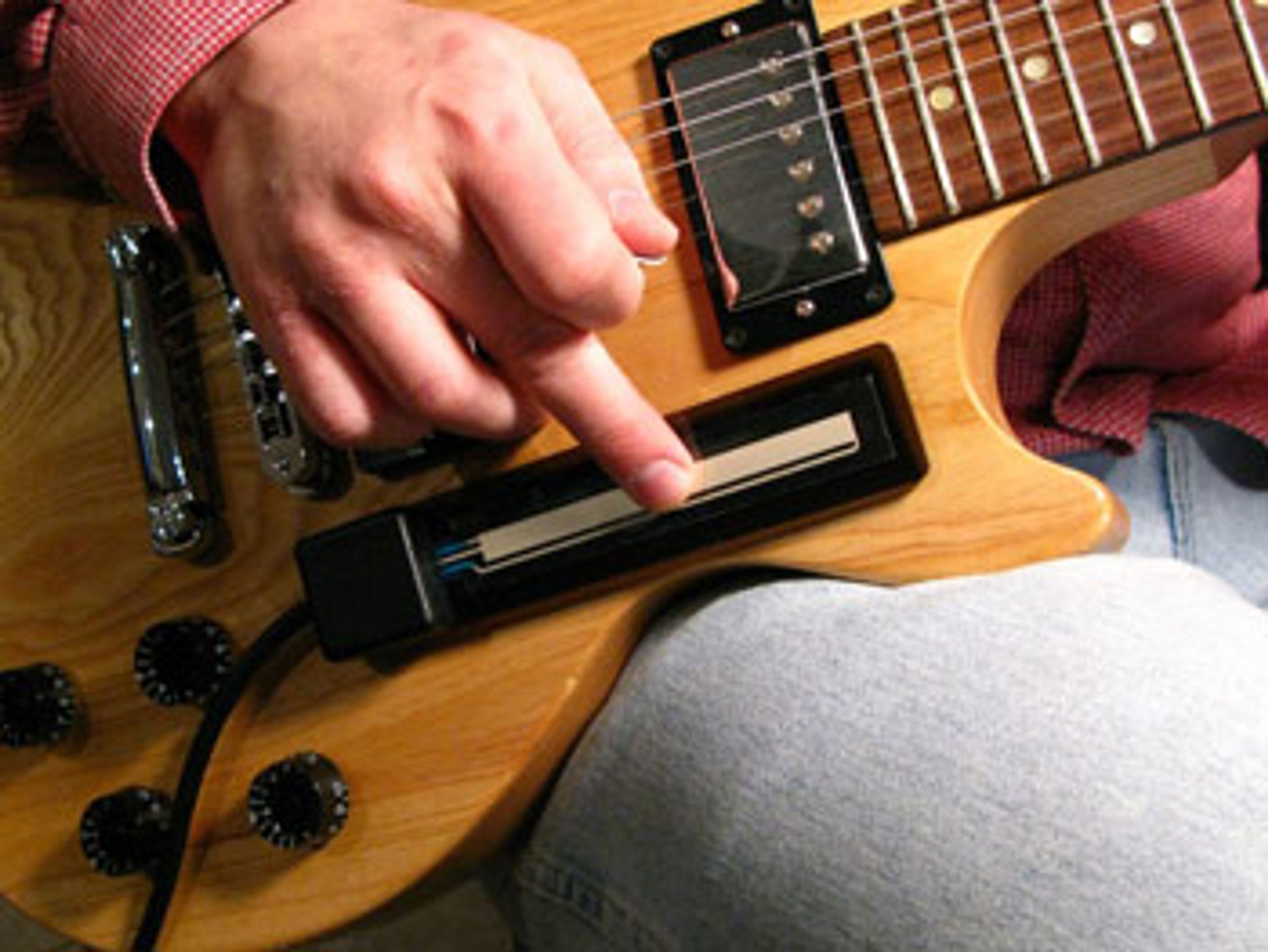

IDEA: Kilpatrick Audio used to do a ribbon-controller that would look right at home on the control plate — Add that and have it control the chaos of an onboard Fact Fuzzory type of circuit, for example... ONLY the ribbon-controller and it only comes on when you touch the ribbon-controller, otherwise fully bypassed...
That idea is pretty rad! Gonna have to research that ribbon controller a bit
