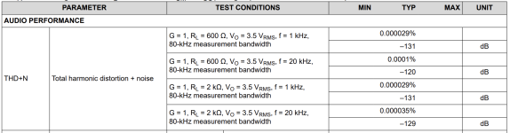

Is it safe to assume the NE5532 on the top right is from the new process that has the specs changed for the worse? Should I just hook one up to +/- 20V and see if the magic smoke comes out?
I got a mixed bag of both kinds in a single order from a trustworthy supplier. TL072 is included for reference, from the same order. My guess is the date codes mean 2014 on the left (and TL072) and 2022 on the right but I'm not really sure. The pins look different on the one on the right. The TI website wasn't very helpful toward checking the date codes.
I'm really going to treasure the old style NE5532 since they're spec'd for 600 ohm loads.
