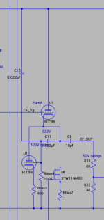

It occurred to me last night, an option here issue the second ecc99 triode. I know TubeCad loves doing this for his headphone amps, but in this instance it works nicely. I may add a grid blocker to prevent RF interference on the output creating noise.
This option provides a little more mA swing and means I don't need the mosfet or the DC for the grid. It's also a little push-pull which helps but remains firmly in the class A operation. There would be some cancellation (as you're running NFB into the grid of the lower ecc99) however if you want some subtle overdrive tone then you can increase the size of C11 here - it seems to create a more lopsided waveform.

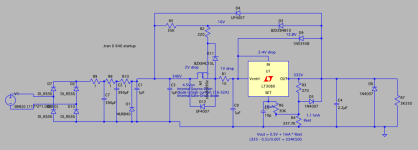

The Maida regulator is simple yet brilliant in its concept - it allows a low voltage regulator (LVR) to be used in a high voltage (way beyond the LVR limits). There's examples of this regulator running at over 300Vdc with LM317s, with 3080 and even 3042 LDO regulators! The 3042 can reduce your power ripple on 300+V to below 5uV. Yes microvolts.
The way it works is simple - a mosfet creates a small working window floating just below the 340Vdc input. With the floating window being about, say about 12V, the low voltage regulator only 'sees' the 12V with the ripple noise, so it cancels out the ripple noise on that 12V leaving you with a very clean high voltage output at the expense of loosing around 12V in this example of the output B+. In reality if you can reduce the ripple to a few volts, to fit within the window, then that window doesn't need to be that big. The 3080 drops out at 1V so there's the minimum drop but your noise may be more than that window can support.
The down side of a maida regulator is finding a mosfet with a DC Safe Operation Area (SOA) that supports continuous load at the high voltage on switch on (the mosfet sees the entire HV on startup). Most mosfets are now optimised for pulse operation for switching supplies and don't have the prerequisite DC SOA.
I just so happened to explore maida regulators with a LT3080 regulator at high voltage for a headphone amp. Here's the PSRR for the LT3080:
As I'm pulling about 100mA only.. I'm looking at the upper line. So 85dB 100Hz noise rejection up to beyond the guitar range.. and 80dB well into the top limit of 20KHz. So about that 59dB... :devilish:
What we should see is that the noise disappears, although we will sacrifice some B+ to the regulator gods, so we may loose 2-5Vdc. Any lower and the 3080 may drop out (shut down).

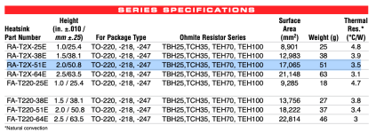

Now comes the safety notice.. the STW mosfet and the LT3080 both have heatsinks attached.. but the rear of the devices is attached to the out pin.. which makes the heatsinks sit at 340Vdc.. (even with insulators the screw threads, or even plastic screws, the metal pieces are within the safety tolerance for spark over for these voltages. So you treat as if they're ⚡⚡monoliths of 340Vdc doom⚡⚡...
I have one that's really hacked together on matrix board, and it scares me as the heat sink are on both sides to keep the two devices as close as possible. At least the 3080 is running a full positive guard on the set pin 😁
I may be tempted to remake the board using some turret board. Although a final option is to make my own PCB (I have some UV sensitive board and developer but it's a fuss) and if I'm doing that then I may as well make one for the entire compressor. The UV PCB is double sided too... and is still inside the competition rules as it's crap I have lying around.
The good news is that it will solve the noise problem.. with the remaining noisefloor being the tubes. Typically they're about -70dB to -80dB, and even with running differential amps to cancel some noise, it's not going to get much better.

EDIT: For now I think I will make the regulator a little more manageable - moving the second heat sink form the bottom side. It should have no real effect moving the mosfet a couple of mm away. It will make it less of a death trap and make it bench mountable.
