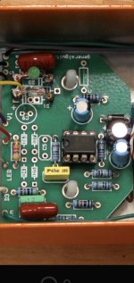

They're both unbelievable (in their digital form anyway). The bosstone looks like I can just get a pcb from fuzz dog in the UK and Ben Adrian has spilled the beans on the KWB on his blog, except for one of the pots. I'll have to do some breadboarding to see what I like.

Have you built a KWB then @Feral Feline? What value did you use for the GSE knob?' I'm pretty sure I should have everything in my stash to make one.

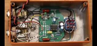

Thanks @Feral Feline I hadn't seen that post yet. I've got a bunch of other posts, guts shots screenshot on my phone and the only part I can't seem to find info on is the GSE pot

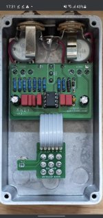

Scott Evans (who's in Kowloon Walled City) did his own KWB run last year and says he'll do another "this summer":
If you want to try that route vs sussing out mods. But then, who doesn't love modding a 250...?
Just had a look and his seem to be missing the GSE knob which I quite like using in my helix.
I've got some good gutshots including one from Scott Evans
