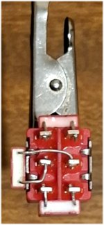

Sorry Chuck, I’m probably looking right at it. How are you changing 3 pair of caps with an on/off/on?
Me too. I ran sims before I built the breadboard and saw the 55Hz peak. So I listened to a demo on YouTube and it became clear that 55Hz is what MXR intended.
I owned one of these and tried out the lore, stacked it with an op amp muff, into a cab with a G12-M Celestion speaker. It WAS pretty cool. For that one sound. I’m going to try out the circuit with your mods - looks pretty cool and way more usable than stock.
I knew someone was going to ask...
C6 & C8 are always connected. We either connect C6a & C8a in parallel, or C6b & C8b in parallel, or nothing in parallel. The resulting capacitance is:
35.2nF, 17.2nF or 2.2nF, in that order.
