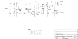

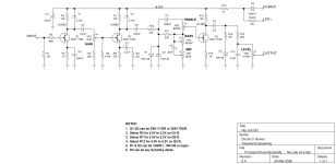

Another OD inspired by HamishR down under in Perth. His earlier versions had four JFETs and a different tone stack. I took one of the later versions, deleted a source-follower stage between the clipping diodes and FMV tone stack, fiddled with the EQ and clipping a bit and here's where I ended up. He used 2SK170GR JFETs. I don't have any of those, but I do have plenty of 2SK117GR. They are close enough to not require too much fiddling to get the bias and gain right. Plays clean with GAIN below 1. We get edge of breakup from around 1 to 4, depending on the signal strength at the input. There is a healthy dose of gain, distortion and compression when GAIN is turned past 6. All of the distortion comes from Q2 and D1-D3. If you're looking for a light OD, you can eliminate C5 & R9. There is usually one more cap in the tone stack, but since I did not need or want DC isolation there, I jumpered the cap that would normally be between R11/C8 & the BASS & TREBLE pots. Q3 provides volume recovery. Its gain is low enough that it runs clean. Mellow harmonics and a smooth note decay.
