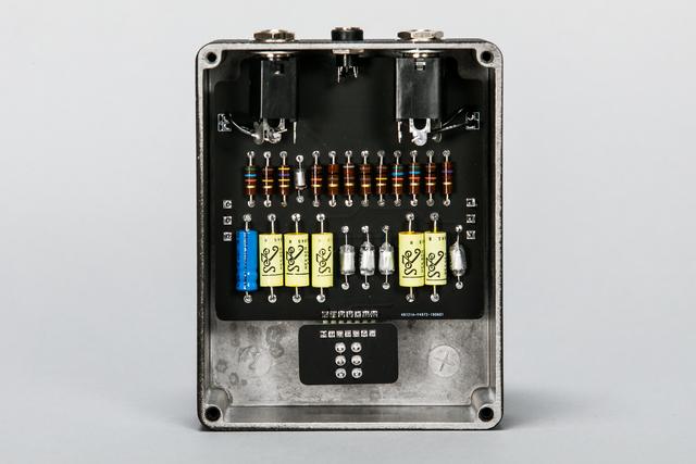

Generally, though, I've found no sonic advantage to audiophile parts in low voltage pedals. I use them for fun and aesthetics, like in this Lunar Module clone I made with Sozo caps, carbon comp resistors, polystyrenes, etc. Came out sounding indistinguishable from the small version with jellybean parts- but it was fun!
