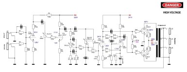

Looking closer at this I see two (of possibly several) options:
Option #1:
I like your original suggestion of replacing R14 and R15 with a 1m pot. It changes the circuit very little and gives the volume control you desire. I would use an audio taper pot.
This gives the widest range of volume control, possibly overdriving the PI (edit: and/or Power Tubes) at higher settings.
Option #2 would be the top schematic. This retains R14 as R5 (top 470k) and replaces R15 with a 1m (VR4) pot in parallel with a 1m (R7) resistor. The resistor in parallel with the pot gives an overall resistance of 500k ohms. Placing a fixed resistor in parallel with a linear taper pot is a method of creating an "audio taper like" pot when an audio taper pot is not available. (The fixed 1m resistor and 1m pot could be replaced with an audio taper 500k pot with the same result.) This would give a volume range that maxes at the same fixed volume as the original TT B-Flex.
10K gridstopper for V2a aka gainstage before splitload PI stage.
@GAStan cathodyne splitter there so unity gain at most and poor resistance for blocking distortion.
I’d try option 1 first to see what are V2a+b limits with signal level.
Edit. That’s NOT cathodyne phase splitter. Early long tail pair or what the heck? Or is it some iteration of paraphase?
Ok, let's try Option 1 and see if the overdriven V2a+b sound musicals. If not I'll go for option 2.
Ok for the grid stopper on V2a, but why not on V2b also ?
I also notice there are no grid stopper on V1a and V1b. Could this be an good enhancement to add grid stopper here too ? My room is probably not RFI/HFI free..
What kind of resistors should grid stopper be (power wise) - 1/2W ? 1W ? More ?

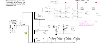

I repost the schematic and the layout here to avoid switching back to page 1 :
I have another question, there is an unused 5V supply in the PT. Can I use it to light LEDs inside the enclosure ?

0.5-1W is all ok. The amps I have worked with have had 0.25-0.5W grid stoppers even on power tubes. I use bigger wattage ones as they’re sturdier for floating connections and have longer leads.
Btw I looked PI on latest schematic you posted and it’s not split-load PI, but grid stopper is still beneficial at v2a as it makes a long run from previous plate/stage.
It may be a paraphrase inverter as I found someone who made some modifications in a that amp years ago mentioning it :
Didn’t notice this earlier, but if you want to pollute your signal with noise go for it! With careful planning it’s doable, but there’s a reason why chassis lights are rare. Gigging people have problems with stage lights etc. My 100w amp picks ticking noise from slightly worn light ballasts few meters away so I play my rehearsals without lights. :D

The amp uses a “paraphase invertor” circuit, and the anode voltages of the two tubes are very unbalanced. According to the amp’s documentation, I should have 241V and 220V, but I measured 300V and 200V.
I'm wondering if I can balance this out using resistors R17 and R19, which form a voltage divider bridge...
Is there a paraphase inverter specialist among you?
I'm reposting the diagram of the phase-inverter stage here:

Haven’t messed with see-saw floating paraphases, but above is what the bible has to say of your PI. Balance is greater with fig.12.35 which drops R20 and jumpers C10.
BUT
I would start tube rolling. Change V1 and V2 positions to see if current V2 in use has really unbalanced halves. If voltages look better with other tube in V2 then good! But remember that anode voltage balance doesn’t exactly tell how close output balance is. If voltage balance doesn’t get better with tube rolling, then it’s wise to check if you have too much feedback. Go disconnecting feedback lead from OT secondary to see if there’s too negative feedback via R23 causing the loss of output. If output difference is great compared for stock circuit with FB, time to adjust R23 value.
I just modelled your PI with my awesome tool ;) and I am getting V2a at 229V and V2b at 219V. It's not a perfect model, but I would be surprised if it were more than a few % off. It's also the best balance you can have with E12 values apparently. Are you sure you have the right resistors built in? And your grid leaks are properly grounded to an actual ground?
(Don't mind the imperfect wires overlapping, still working on that).
I've find this afternoon I forgot the 220R resistor (R18), hidden in the centre of the V2 socket.
Can you try without 220R (cathode resistor) in your modelling app ?
As soon as I'm back home tomorrow morning, I'll solder R18. Maybe that's also why the amp is low volume.
My tool shows DC in yellow. You are between a cap and ground there so 0DC is expected. What you have is a severely unbalanced PI that can’t drive a power pair properly. Rebalance it and it will be fine.
