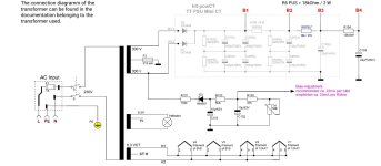

I’m planning to build a tube bass amp using this kit from Tube Town in Germany. It’s a kit inspired by Ampeg’s Portaflex series.
I’m thinking of making a few modifications:
- Add a volume potentiometer (1 Mohm log) in place of resistors R14 and R15. Passinwind recommended a useful improvement: using a switchable potentiometer to add a bright cap, but I’m having trouble determining the value of that capacitor ( fc=1/2πRC).
- Use output jack with switching contact to incorporate a dummy load and prevent damage if the amp is plugged in without a load.
- Add a DI output before the volume knob
- Add a Stand-By switch on HV1/HV2.
I’d love to hear your thoughts. I’ve already built a pair of pedals based on kits designed by Nathan from Sushibox FX. Succesfully and I'm having lot of joy using them. But this will be my first DIY amp. I plan to connect it to an Ampeg SVT 210 cabinet.

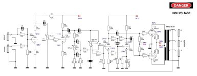

The standby switch isn’t really useful. A MV definitely is. You could also play with changing the tonestack structure to give you more control and possibly make the bright cap on the MV less important.
Do you think I should put the MV before the tonestack ? Is that what you mean by "changing the tonestack structure" ?
1. If I did a master volume, I’d use a post-phase inverter master volume. The Lar-Mar example works well.
2. The dummy resistor is going to be larger in size, so allow space!
3. DI out might work best off the R14/R15 going into the phase inverter.
4. I would see if there’s a way to bring down the plate voltages of B+1 and B+2. Sure, some 6v6gt can take up to 400vdc, but you’ll have to watch the bias. If you can get to 375vdc, they’ll be a bit happier
Quick look on schematic had me thinking it might be a noisy circuit and need tweaks f.ex. input resistor values.
With that supply; definately!
I've found this schematic.
If I understand correctly, I'll need to replace R24 and R25 with a two-stage 250kohm log potentiometer. And add 2x1.8Mohm safety resistors to maintain the initial values of approx 270k (220k in that case).
I also found a variation (Frondelli MV) :
Any thoughts about this one vs the Lar-Mar solution ?
OK, but won't that reduce the amp's power ? It's only 18W...
Noise is definitely the last thing I want. What do you recommend regarding the input resistors ? Are you talking about R1 and R2 ?

Bias probe is a gimmick if you don’t bias as your profession. Just stick individual 10r resistors between tube socket pin1+8 and GND. That’s your bias probe there to take accurate enough DMM reading for biasing. Just make sure you match resistors to each other close enough.
It really depends what you’re using the amp with. Maybe use stock values first and if needed adjust from there, 20-33K/470k-1M? But will it then have PortaFlex sound anymore, dunno!
Type2 Lar-Mar is the one that a lot of DIY people use. Make sure to have those safety resistors (2.2M is pretty common)
Dropping the voltage a bit does drop some output, but the difference between 5W (like a champ) and 18W when fully cranked is different but not insanely different (because volume and decibels are logarithmic).
I think a MV between tonestack and PI is sufficient, but some prefer a post PI MV.
And by changing the tonestack I mean using something more classical like a Marshall or Fender TMB topology.
As for the bias probes, to be honest, if you are building an amp, you shouldn't be needing those... just a multimeter on a pin with an alligator on the chassis ground screw and roll really.
I need to think about that—it might be interesting to have a mid-range control. But I'm afraid that if I give up the Baxandall tone stack, I'll lose the “Ampeg Portaflex sound" (even if SVTs are famous for their midrange control...).

On the bias probe, I agree with @JohnnyCreepy except I prefer to use 1r resistors because the math is easier: 1mV=1mA. I install these with an external test points on my amps so I can set/check bias without opening up the amp. Install one 1ohm resistor per power tube between cathode and ground. I use 1 watt resistors but have read where others prefer 1/2 watt. This reading will be slightly higher than actual anode current because both anode and grid current flow through cathode.
My preference is the pre-inverter volume control you mention in post #1. This is actually how Dumble did it in his amps that have been documented.

That's a great idea; I'll look into where to place the bias adjustment on the back panel. I'll also need to put the adjustment potentiometer there.
I'll try to find the Dumble thread about it but can you explain why this is your preference vs Lar-Mar MV ?
At first, I opted for the MV after the tone stack, based on how my C2CE pedals are built.
Here are several examples of Dumble amps with schematics in PDF format. Serial#s 102, 124, & 183 as well as the Steel String Singer (SSS) sticky threads would be good places to start.
Consequently I have built four different 100 watt amps based on #s 102, 124, 183 and SSS 002, the SSS is my avatar here. I am near completion of a Bluesmaster which will be my fifth 100 watt amp.
To be honest, it is my preference because it is all I have used thus far. It has worked well for me so I have not really considered anything else. If I were in your shoes I would likely use it because it alters the existing circuit very little and is easier to implement. For me to speak of the Lar-Mar would be unfair to it and you because I would just be repeating what I have read on the internet rather than speaking from personal experience.

This is the pot I use for bias.

Which solutions to use for the Master Volume, keeping in mind that there aren’t really any right or wrong methods. I just need to choose the one that works best for me based on the pros and cons of each.
When using 6v6 with voltages higher than or near limit mentioned on datasheet and having bias tapped from HV I’d go for pre-PI master just to be sure not to mess too much with power tube grid-to-cathode max resistance. And if going with post-PI master then consider safe working area to from datasheet and forum talks.

As for the pre-PIMV, I found two solutions and I can't figure out which one to choose :
- Here's the Volume pot from an amp kit similar to the TT B-Flex. It features two resistors (voltage divider shape, 470k and 1Mohm) + a 1Mohm pot :
Larger Picture :
- Here is the Nobelium DI, where there is a 250k pot without the voltage divider before :
Is there a good reason to keep the two resistors before (which are R14 and R15 in the TT B-Flex ?
At this point, I need to mention I plan to add a DI out circuit from C2CE, with the Unagi transformer, just before the MV pot, like Nathan've done it in the Nobelium DI.
I like your original suggestion of replacing R14 and R15 with a 1m pot. It changes the circuit very little and gives the volume control you desire. I would use an audio taper pot.
