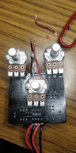

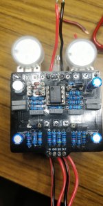

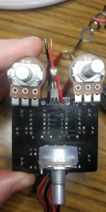

Hi folks, my mate posted me his Uberdrive build that is not producing any sound. Apart from flux on the board - which I've carefully cleaned, avoiding the pots - I can't see too much wrong with it. I pulled it out of the enclosure and sat it on the Auditorium and it's still not making a sound. LED comes on, bypass was working in the enclosure. He's used 2N3904 transistors in place of the 2SC732s called in the BOM, is that ok? I checked the pinout and believe they need to be flipped around, hence looking like they're in backwards in the photos. Can anyone spot anything? What should I check next?

I don’t see anything obviously wrong. Did you check all component values? After that, it may be time to measure some voltages on transistors and IC.

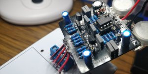

I rigged the 2N3904s as in the thread above but no joy. IMG_20210714_193717_copy_3456x1728.jpg
Here are some measurements. I don't know enough yet to know what they mean.
IC1
P1: 8.49V
P2: 7.79V
P3: 7.73V
P4: 0V
P5: 8.49V
P6: 8.52V
P7: 8.5V
P8: 9.06V
D1
A: 8.16V
K: 7.81V
D2
A: 7.81V
K: 8.51V
D3
A: 8.51V
K: 7.81V
Q1
E: 3.59V
C: 9V
B: 4.03V
Q2
E: 2.99V
C: 9.07V
B: 3.36V
Happy to measure again if some of that is clearly wrong, this is only the second time I've measured voltages. Cheers.
Looking over it I’m at a loss too. If you hadn’t already measured the socketed components I would have said it might be the sockets. You might have to bite the bullet and trace the circuit all the way through as annoying as it is to do
Here’s a gutshot of my working build on the off chance it helps at all also but I think we all agree nothing looks off visually on yours. I used 2n5089s I think
Your op amp voltages are off input and output pins 1,2,3,5,6,7 should be half power if it's 9v around 4.5v
You've got power and ground pins 4 and 8 as it should be, check what voltage you get on the empty socket pin 3
Agreed, Do you have a spare dual opamp you can try that you know that works ie TL072, OPA 2134
I don't like the look of that ? JRC4558.
Solved - dead 4558. I double-checked the voltages again and confirmed they were mostly too high. I swapped in a 4558 from my Nobleman and took voltages, all roughly around 4.5V apart from 0V and 9V on their respective pins. So I plugged it in and we have life and glorious sound. I'm sending it back to my mate without a chip and he can do the honours and fire it up. Thanks for your help everyone! :D
