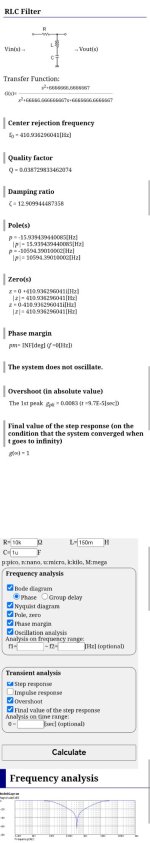

1) I'd prefer using a smaller inductor and a larger value capacitor due to limited space in a typical jaguar routing... while a semihollow could fit a typical 1,5H inductor, it would prove quite tricky on a standard jaguar since such components are pretty big
2) to me, a vintage sound is way less prominent in the low mids, but retains some bass and treble, with kind of a woody characteristic
I may have found some values for a 150mH inductor using an online filter calculator, but I won't be able to try this in a month or so. Here is a screen from my phone, I went for the same data as for the 1,5H version:
p.s. If someone would like to try it before I do, please post your results!
