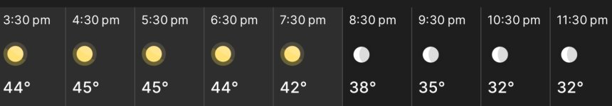

today’s forecast has been like this 🥵 (degrees celsius)
