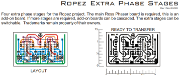

Yessir, tonepad has a mod where you can add additional stages. It’s basically unusable but sounds crazy. I never really noticed any low ended loss, but I was playing on a full bass stack. I really only used it playing sweet emotion.
