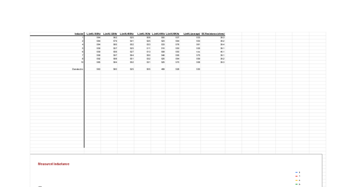

Another note: I've added a few more inductors to my document.
