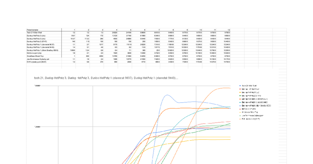

Wah Inductors. No hype. Just measurements.
So I'm lagging like fuck on my international shipments. But I'm gonna add in a little extra somethin somethin for yall.
As for now, I've added a few more inductors to my original doc, and I've made this one comparing various potentiometers:
Other notes:
Mission rewah: this guy ain't made no more. Got two of em. The standard and the pro. Gonna trace em out and see what the little dip switches on the inside do. Got a feeling about a couple of 'em.
Looks like the only difference between the "pro" and the standard is the inductor. The "pro" uses a cine-mag crossover inductor with several different taps on it. The only tap that is actually used is the 520mH tap: all the rest are electrically isolated from the circuit. I had read some speculation online that the little internal dip switches on this guy would switch between the taps on the inductor: this is not the case.
The standard model uses a yellow fasel. Which is a great inductor.
The biggest difference between the two? The cine-mag inductor has the highest q I think I've ever measured in the 4k range.
I've also picked up a few off brand wahs to check out: the Tech 21 Killer Wail, made by Onerr, uses a toroid that initially measures pretty "blah", but sounds damned decent in practice. They achieve this by adding a 47 ohm resistor in series with the inductor coil, bumping the "q" resistor and input resistor to 100K, and dropping the resistance off the emitter of Q1 to 220 ohms. Makes for a decent little wah!
I've also picked up an Ibanez WF-10 that is in *shitty* condition. I'm not sure if I'm gonna try to salvage the plastic enclosure or not yet: trying to 3d print the enclosure has been an exercise in failure, I need to invest in a dedicated support filament in order to make this thing work.
Also bought a Twin Peaks cause I wanted to crack it open and see what they did on the inside. All SMD. dammit...

Does anybody know what toroid is inside a fasel wah?
I’ve build pedal kits for a while now but never had a go at my own inductors.
I’ve bought a wah inductor kit from a place in Germany which has a bobbin, n48 pot core, clip and the terminal, similar looking to the “halo” i think.
The fasels look simple enough though - just a toroid, wire, mount and cover.
I’ve found a place in the UK that has a similar mount that “might” work (similar size etc) but am unsure about what toroid to use:
Anyone know whats in the fasels?
Its likely an MnZn ferrite, TDK's n30 or n48 is probably a good place to start. ~14mm diameter. You'll have a tough time tracking down the exact specs, dunlop is gonna keep a tight lock on that info.
That said...toroids are tricky. Its possible to wind one for a wah by hand, but it's a bear. The wires are fine and getting the spacing right is critical.
Dunlop's modern day fasels are going to be machine-wound. There are designs online for toroid winding machines if you have access to a 3d printer, but they're meant for toroids that are more in the 140mm diameter range.
Its a tricky proposal. Honestly: I haven't experimented much with toroids. Never felt the need, truthfully.
While I can't say any of the below for certain, this is the impression I get:
I think it's extremely likely that the transition to toroids for Dunlop was done purely for cost cutting reasons. Pot cores are easy to make, but their assembly and production leaves a lot of openings for QA issues. The halves need to align, the mating surfaces need to be perfectly clean, they need to be clamped with sufficient force and glued, etc.
Toroids, on the other hand, don't suffer from those production issues. They also seem to require a bit less wire, which will save on production costs.
So, I suppose what I'm saying here is that it can be done, but each route requires a bit of work towards honing a process to get a consistent result. Building toroids would be easier, but making a jig or machine to help wind them is going to be more difficult. Pot cores are more difficult to build, but making a machine or jig to wind them is going to be easier.
I have a yellow fasel which was dead (i’ve had it a while but couldnt get any readings) - i’ve opened it up today and it’s definately toroid.
Looked like the wire going to one of the pins was broke close to th toroid.
I’ve prized it out of the cup and removed the wires - on my digital calipers it measures 12.7mm x 7.7mm x 6.4mm and looks grey painted but i cant see any codes/writing on it.
I’ve got some 38awg wire so might as well have a go at rewinding it.
Any ideas how many winds it will need?
I was hoping to try unravel the original wire to get an approximate length but it was partially covered in some resin or goop.
The mount and cover are in good condition though.
Took a while to prize it out.
Honestly: my recommendation would be to take that 38awg you have and...very...carefully...under a magnifying glass with a fine tip....try to extend the ends of the wire.
Its definitely doable. If you can pull it off, it'll be wayyyy easier than re-winding the core. Just be very careful, don't touch the rest of the wires coming off the core with the soldering iron: this is enamel or polymer-coated "magnet" wire...super thinly insulated and very easy to burn through with a soldering iron. If you burn through the insulation on the windings, you'll probably create a short.
Don't worry if you have to undo a wrap or two to do this: thats not gonna make a huge difference at the end of the day. Once you have it extended, you may want to throw dab a little flexible glue on top of the joint you made to re-insulate the wires. Run that to a post, wrap the wire around the post a few times, solder the wire to the post, and you should be good to go.
If you have to re-wind: this is what you'll need to do.
Measure the wire Dunlop used with a pair of high-quality calipers. Find a magnet wire with that same diameter. Then, un-wind the toroid by hand, and count the wraps as you do so. This will be tedious, but it's necessary.
Then, measure the length of the wire you unwrapped, cut a legth of your magnet wire that is about 12" longer.
Then, re-wind the toroid by hand. Leave 6" of excess hanging loose when you start winding (this will eventually be soldered to a post and is the "start" of your inductor) Try to keep constant tension on the windings (not so tight that you break the wire, but it should hug the ferrite core), and try not to overlap windings. Keep relatively even spacing between the windings.
You'll need to do keep count as you wind, and you'll need to wrap the wire the same number of times that you counted when you un-wrapped. You should have another 6" left when you finish. That'll be your "end" and it'll get wrapped and soldered to a second post.
