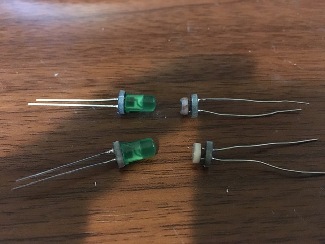

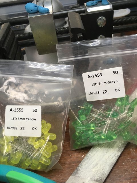

So after some digging in my closet, I actually found some diffused 5mm Tayda LEDs - green (A1-1553) and yellow (A-1555). These must be 4-5 years old, so I can't be sure it's what they're still selling.
With the stock values (1K5), the current for the LED drivers is limited to about 5ma. At which, I got:
Green: 3.2K
Yellow: 860R
So I made some new couplers with the Tayda green, swapped back in the standard 1K5 CLR and voila, sounds great and controls work just as you'd expect.
So, 5516 and Tayda green and I'd say you're set. And I'd wager you're getting a better response with that combo than the VTL5C4.

The Tayda diffused green works really well for me and I think if people want to just build it with that and 5516, they'll get good results. On their website, they characterize it as 2,000 to 3,000 MCD, which is off my a factor of 100 I suspect.

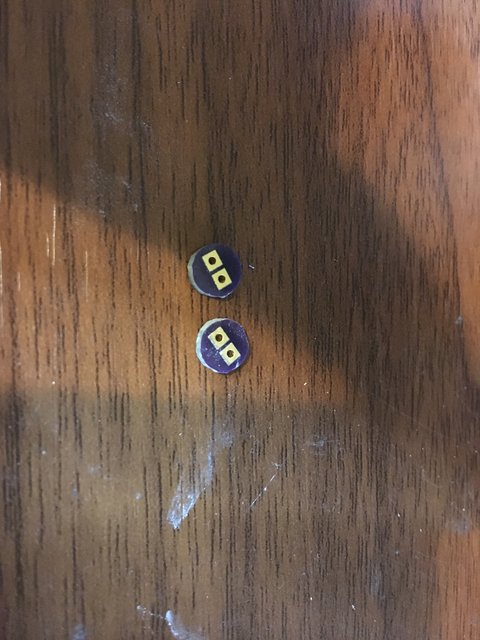

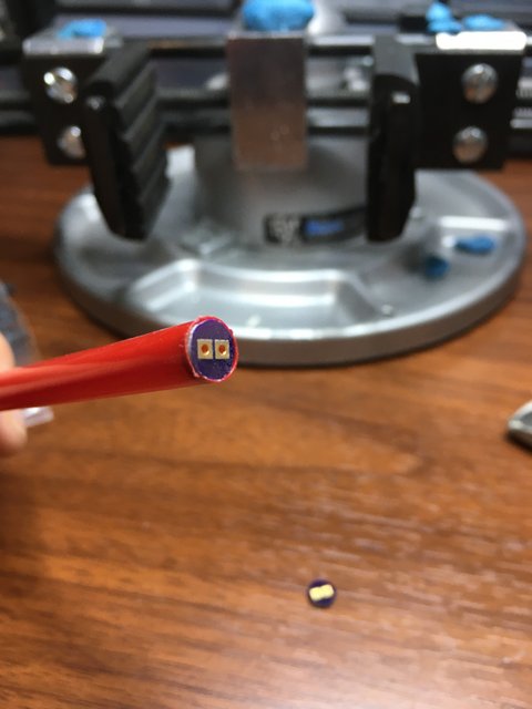

I have them touching face-to-face. I got some little round PCBs to solder the LED and LDR to fit perfectly in a milkshake straw, which I then cover with heat shrink. But if I do my own layout, I think I've got an even easier solution worked out. Stay tuned.
